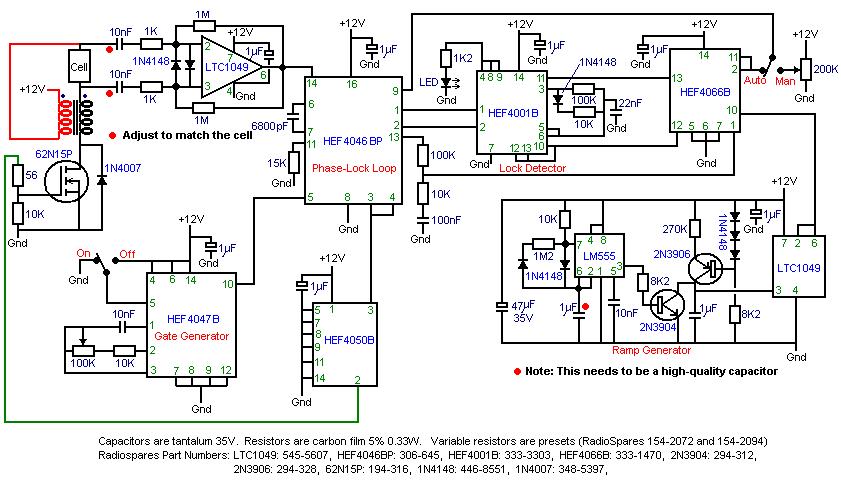

Well, I will be using Dave Lawton's PLL circuit for my project, because that one is capable of automatically maintaining the resonance within the cell:
http://www.free-energy-info.tuks.nl/Chapt10.html
Quote
Dave Lawton uses a different method as he has designed and built a Phase-Lock Loop ("PLL") circuit which does the same thing that Stan Meyer's automatic circuit did.
This circuit has been used very successfully by a number of people.
It works by using a so called "Phase Locked Loop" or PLL:
http://en.wikipedia.org/wiki/Phase-locked_loop
Quote
A phase-locked loop or phase lock loop (PLL) is a control system that generates an output signal whose phase is related to the phase of an input signal. While there are several differing types, it is easy to initially visualize as an electronic circuit consisting of a variable frequency oscillator and a phase detector. The oscillator generates a periodic signal. The phase detector compares the phase of that signal with the phase of the input periodic signal and adjusts the oscillator to keep the phases matched. Bringing the output signal back toward the input signal for comparison is called a feedback loop since the output is 'fed back' toward the input forming a loop.
This circuit can be ordered in kit form from the UK:
http://www.courtiestown.co.uk/index.php/electrolysers/dave-lawton.html
So, this part of the project can be solved with an off-the-shelf kit. :)

Yes, but also not totally. I don't think the own resonance of the pipes is the big number to follow. They should vibrate at a lower derivative of the real important frequency.
Say the main process frequency is 5.7 Mhz   (at a certain fieldstrength)
The tubes, when beaten give a sound of 8.4 KHz
Question: how much to shorten the inner tube to get it harmonic to the rest?
Divide the frequencies, go to the nearest whole number and adjust the tubes.
Preferably to a higher frequency, cause its easier to shorten then to lenghten. :)

I won't be shortening the pipes. I don't believe that is necessary, because it's the fluid which is supposed to vibrate and NOT the pipes themselves, just like it's the air that vibrates in an organ pipe or an oxen horn (the instrument I "play") and NOT the instrument itself.
And even when tuning of the pipes themselves would be helpful, the fact that Cramton's pipes are put into place holders after tuning, which restricts the tube's vibration and thus changes it's resonance frequency, would totally ruin the whole tuning effort.
So, because Cramton's cell worked fine, even though he tuned the pipes "in the air" before mounting which would be totally useless because of the mounting of the pipes in place holders, I am pretty sure there is no need at all to do so.
Also consider this image, wherein you see this PLL circuit along with a test cell in the upper part of the picture:
Quote
The two air-core coils are wound separately rather than bi-filar wound, and some experimentation with different types will be undertaken to see the effect on overall gas production. This circuit is shown in the following video, driving a 2.6 inch long pair of electrodes with a 2 mm gap between them, sitting in a test cell. The electrodes have seams and are made of an unknown quality of stainless steel and can be seen at the top of the photograph above. This video shows considerable gas production with almost no current draw and the cell staying completely cool.
The video shows that it works just fine without any tuning of the pipes whatsoever:
https://www.youtube.com/watch?v=XMizRAYdGwA
To me, that makes it pretty clear that the tuning method proposed by Kelly is most likely a total waste of time and effort.
