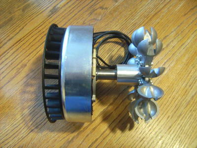

Also noted by TinMan is the Pelton wheel that has a particular characteristic many may have overlooked.  This is one of those devices where the input power is constant and the output load does not influence the input power draw.  Whenever I see such a device that breaks the normal link between input and output, I get curious.  This is a phenomena seen in both the Thane Heins Bi-Toroid Transformer and the Bill Alek Split-Flux Transformer.  When you see this relationship, it's worth taking a second look.

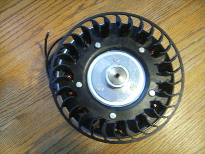

There was one red flag that I noticed while watching the video:
When he shows the unit in operation, without the main cover over the electronics section, I note that the PMA generator is not turning - therefore the pelton wheel is not turning,  Only the motor and pump (???) belted together are turning. - WHY?  No water in the tank?
Why give a demonstration video  showing that only part of the unit is operational if the whole thing is supposed to be operational?
 Also, there are three wires from the PMA for the three phase output that are touching the outrunner bell of the PMA.   The wire would be worn through if it was run for very long like that.
Re: Could this be real or just another gimic?
« Reply #18, on November 3rd, 2014, 07:04 PM »Last edited on November 3rd, 2014, 07:32 PM
I noticed that too Ken, then someone mentioned this particular PMA uses a stationary set of vanes to direct the airflow since the exterior of this PMA does not rotate.  I don't know if that's true seeing how I don't have a similar PMA in my hands to look at.  Anyone have a similar PMA with stationary cooling vanes that can attest to this description?
We "think" this is the type of PMA setup utilized:
http://www.motenergy.com/mepmge.html
So either the interior section rotates or the exterior, but not both.
The description indicates there are no brushes, so the coils are for sure stationary.  That would mean the ceramic magnets are held fast to the outside aluminum ring.  This also means the outside aluminum ring must be connected to the center shaft.  It can only do this on the side with the vanes, so they must turn, best I can tell.
kenssurplus
« Reply #19, on November 3rd, 2014, 07:26 PM »
If the coils (the inside section) are stationary, then the only way for it to make power is for the magnets attached to the outer bell to move.  If the bell is stationary and the coils rotate, then the wires would be all twisted up in a knot comming from the coils (completely unworkable).  I have several of these type outrunner motors, with cooling vanes as shown, and they all mount with a flange that keeps the coils stationary with the outer bell and attached magnets moving past the coils.  The only thing that might be different here is what volt per RPM the unit is designed for.
