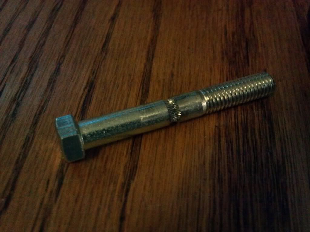

I've never used a knurl before. Guess it's not so bad. I only wish I had a 1/8" instead of the .150" I used. Getting closer! Thanks for all your help guys!
