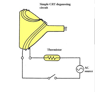

Whats the best way to degauss that is cheap as far as energy is concerned?
Apoc4lypse
Re: Possible Magnet Motor Design using Mu-Metal Shielding (femm files)
« Reply #9, on June 4th, 2018, 10:41 AM »
I was looking at degaussing too a bit when I was working on this. It depends on how much magnetic field you are trying to remove. Some degaussers they have are for demagnetizing big pieces of magnetized metals and they consume far more power than a simple CRT Degausser does because thats a small magnetic field within the monitor being removed.
Although I think the same concept could be applied to the rotor in this case because the magnetization process would be relatively slow for the maion rotor. (Think passing a piece of metal past a neodymium magnet) It gets magnetized the more times it happens, neo magnets will even slightly magnetize metals they are attached to for long periods of time but the magnetization they end up producing is usually pretty small, in a moving system like this it might be a bit bigger though. What I worry about is the eddy currents interacting with the newly formed magnetization on the rotor, making this effect greater.
Degaussing the rotor while its spinning is a great idea though, but I'm not sure what sort of deguasser and how much power would be required to eliminate the types of magnetic fields forming on it... from what I understand deguassing magnetized metals is different than simple deguassing of a CRT monitor, but I don't really understand how that all works.
