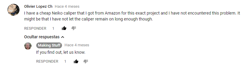

The problem we are having now is with the calipers. The ones from Harbor Freight reset the measurements to zero after 5-10 minutes. Others will power off after 5 minutes. You can see a brief video about it here.
https://youtu.be/i6OT4e8qpBQ
Does anyone know of a different sensor that is readily available? I have seen some use an optical sensor but I can't find much information on the subject.
